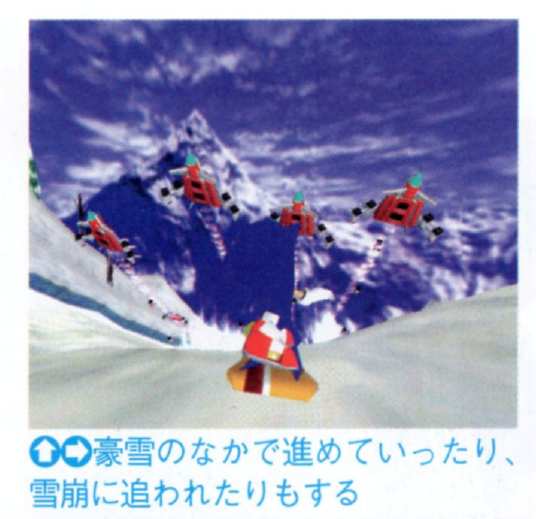

Fixed the E3 file
19:08
It's a little later than the press release version
19:10
AD has all the objects except for these jump ramps, there's only 2 though
19:13
they've buried a capsule in the floor just low enough for the snowboard to reach with a jump lol

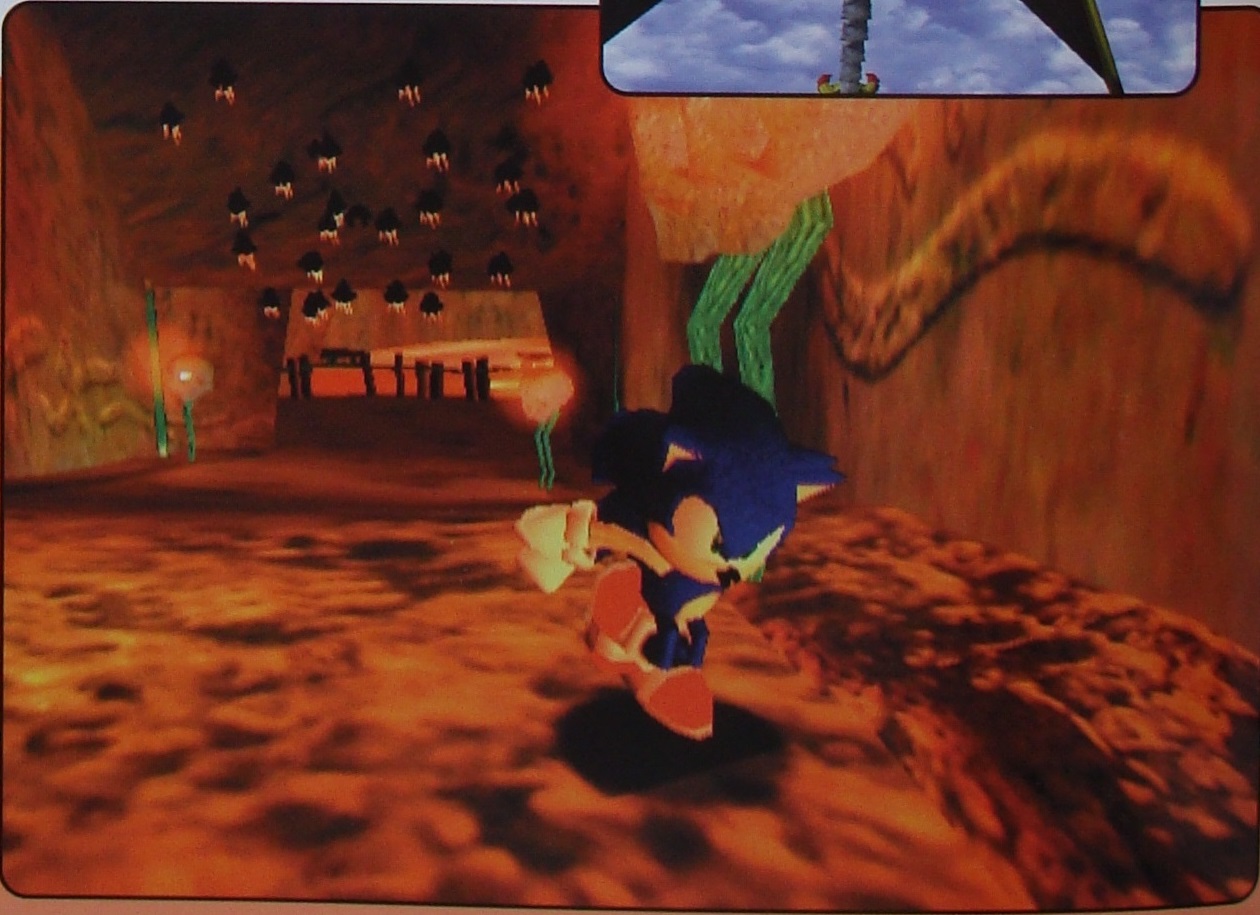

Since some objects in SetEdit draw strings off-screen, does that mean the whole thing was originally further up, kind of like this?
Avatar
supercoolsonic 09.09.2024 21:45
Most likely
Avatar
i was thinking so
21:51
probably changed because of hud stuff and optimising space if so, i didn't like the readability when i tried forcing it to render further up
Avatar
it was probably a copy of the planters here but as a single one, the only ones that exist are green (5 of them in a row) and greenE (3 of them in a row). i think it looks nice if i turn it into a curb... any opinions on what would be best?

Did we ever mention an oddity in the invisible area at coordinates 0,0,0 in Icecap Act 3? there's a function or other that makes Sonic run down the invisible tunnel present oob (edited)
Avatar
i didn't know about that. you're sure its specific code and not just collision flags?
Avatar
not sure
10:13
I'll look into it later today
Avatar
i don't see the tunnel in SALVL so.. (edited)
Avatar
it only triggers when the stage begins. If you put the character back, it doesn't force them to run down that path until you restart the level (edited)
Avatar
it also only makes you run for about 3 seconds before terminating

Avatar
MainJP
on its face it seems like something they were playing with for the cutscene before mounting the board. should check the unveiling footage again
18:58
the presentation where they demoed that level and died to avalanche touching them lol
Avatar

MainJP
looks like it starts the same as the AD one
can only speculate whatever is going on when spawning at 0,0,0 is leftover from earlier then..
19:27
blockout ice cap act 3 type shit
Avatar
Avatar
MainJP
with the sideways gate
the 0,0,0 tunnel goes off to the side in a way that would make the sideways gate make sense i think, if it was placed there ever
