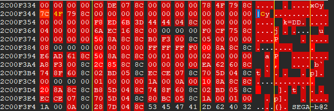

https://discord.com/channels/446023672147345418/446023672147345420/1238458622984327219 in demul you can fix it by setting the byte at 2C6A5563 to 2 (edited)
15:56
I think that's one of these in cameraSystemWork
15:57
rn it gets set to 0 which is how I used to do freecam in 2017 lol

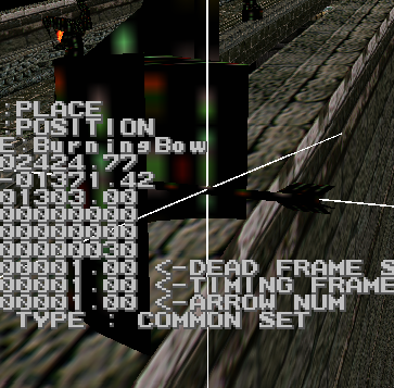

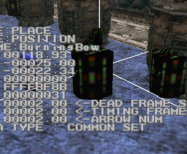

none of these things shoot because their scl values aren't set, I guess the adjustable timing was done afterwards
16:22
some get one or two frames of arrow but that's it lol

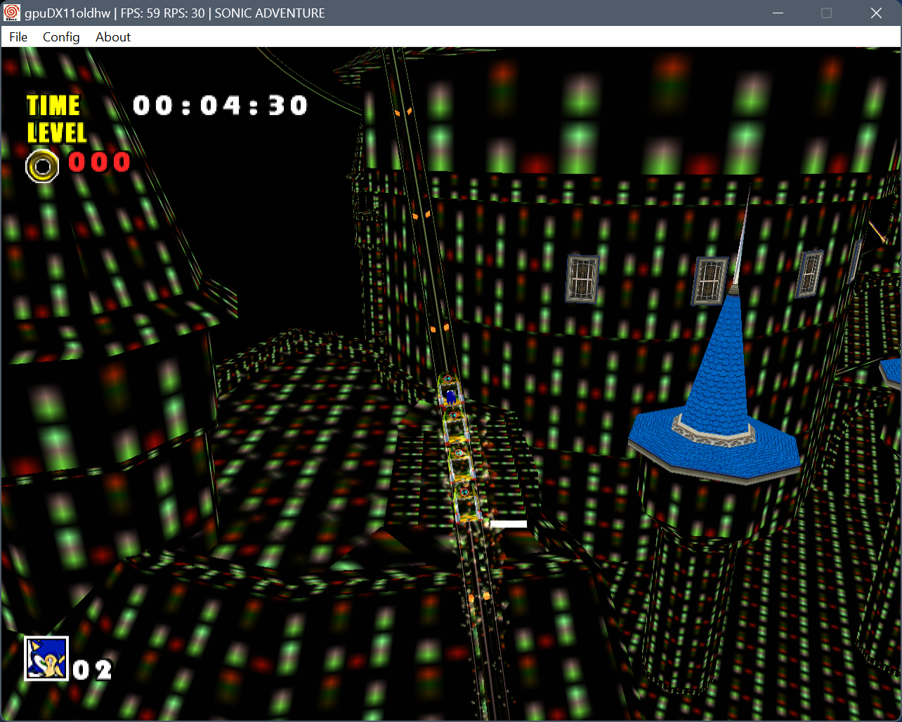

patched with data from Speeps' excel

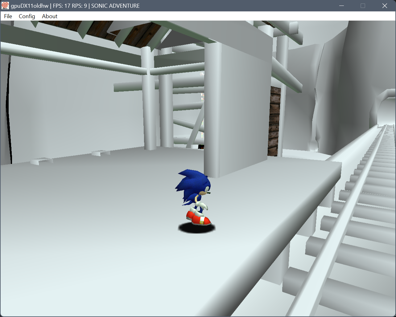

lol wtf Mystic Ruins boots
17:31
kicks you out to title screen after a second though
17:32
Twinkle Circuit also boots
17:34
not sure if this boots normally but pretty cool. Also kicks you out though

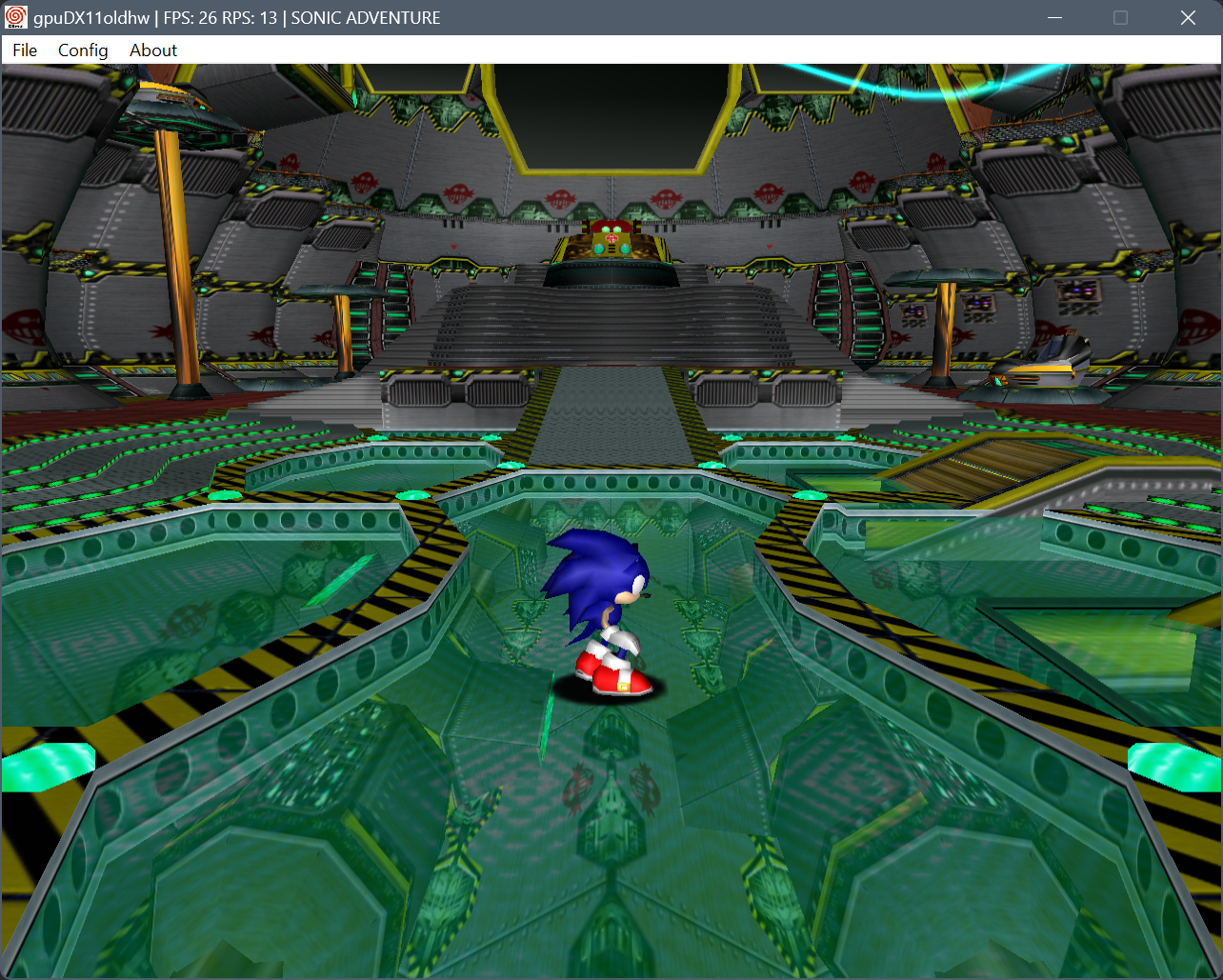

This restores Chaos 2 level and object textures. I haven't been able to get Chaos 2 himself to get textures properly, but the level and objects are all textured.
Avatar
pretty amazing lol
