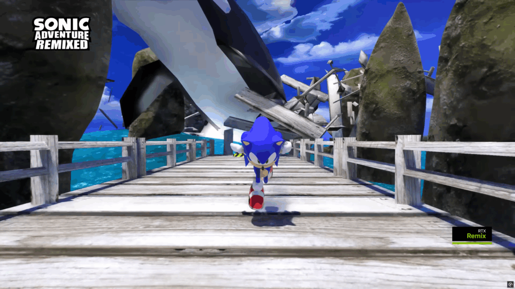

Let’s start with the video itself. Here’s a still frame from the beginning of the video. What does this look like?
If you’re aware of the differences between Sonic Adventure ports, you can easily recognize this is SADX PC with the Mod Loader. Even if you aren’t familiar with the differences between Dreamcast and DX Emerald Coast, the dead giveaway is Sonic’s pose, which he doesn’t use normally. It appears to be Sonic’s “skidding on slope” animation (or an edit of it), which can be seen in the Autodemo prototype, where Sonic’s Light Speed Attack worked differently. To get Sonic to display this animation, his action ID needs to be changed in the player data structure. This can be accomplished with Cheat Engine if you are familiar with the game’s internals and know the exact address, but the most likely way they did it was by using the “Event Animation Editor” feature of Speeps’ Meme Maker mod. The camera zoom-in could’ve been done manually or with Meme Maker’s Camera Editor. Among other mods it is obvious that the video used Dreamcast Conversion (but without Lantern Engine) and some kind of Sonic model mod based on the SA1 Dreamcast Sonic model (previously Kaori claimed it was their model, but later retracted the claim). None of the above are ever mentioned or credited in the video.

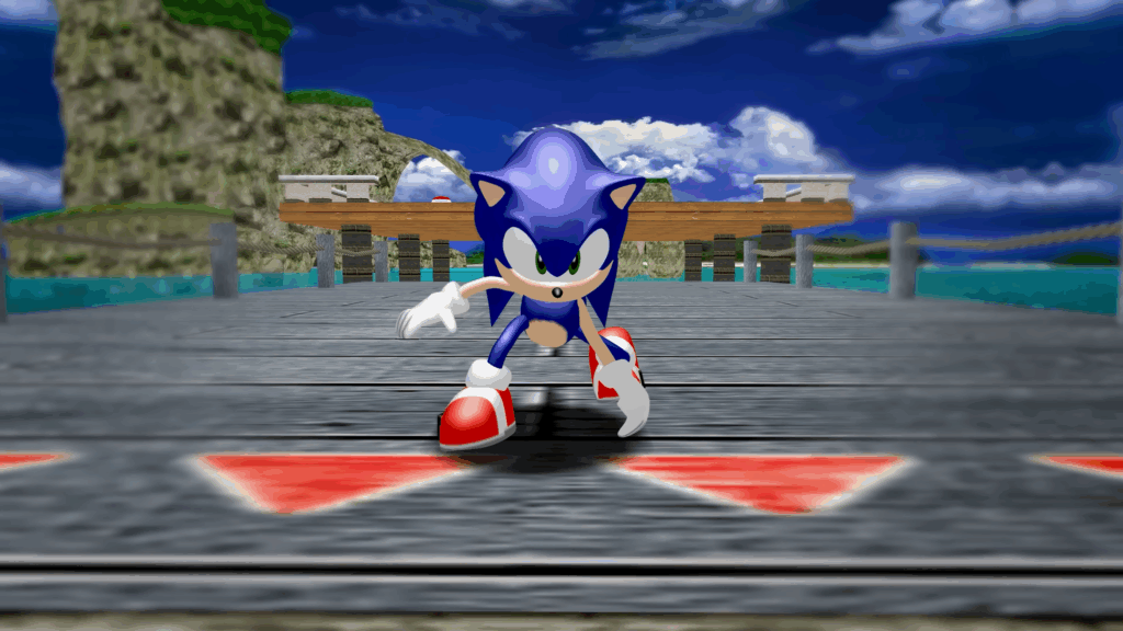

In the part of the video where “Sonic Adventure Remixed” is showcased, it is clear that Dreamcast Conversion is still being used because you can see the vertex distortion effect on the ocean waves from the Dreamcast version.
This effect was removed in SADX, and a slightly edited version of it is restored in the Dreamcast Conversion mod. I talk about this effect on the Dreamcastify blog.

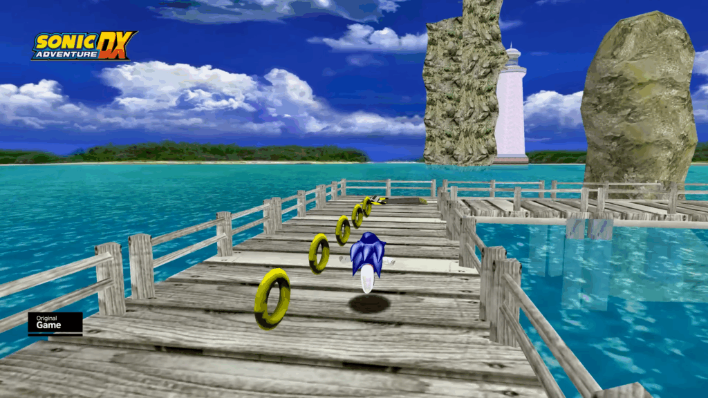

What is “Original Game”?
So, with the above we’ve established that the version of the game shown in the video is definitely using the Mod Loader and various mods. Next, let’s have a look at the snapshot below.
At the bottom left, it says “Original Game”, which is a gross misrepresentation. If they mean “Sonic Adventure DX” as the logo on the top left implies, there is no way this would qualify as the “original game”. To start with, not a single version of Sonic Adventure DX uses the Dreamcast version’s ocean textures in this level. So “Original Game” is actually the 2004 PC port of Sonic Adventure DX modded with the SADX Mod Loader and the Dreamcast Conversion mod (and likely some kind of texture upscale mod), at the very least.

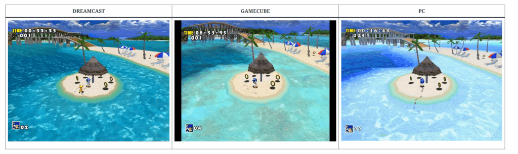

Another thing I find particularly unfortunate is the way the lighting is misrepresented. It looks fullbright in the “Original Game” part of the video because the Lantern Engine mod was disabled. One of the major differences between Dreamcast and DX level models is that the DX models have baked-in vertex colors to compensate for the removal of Lantern Engine. The Dreamcast levels, on the other hand, do not have vertex color data. As a result, if you don’t use Lantern Engine, there will be no lighting on Dreamcast levels among other things. That’s one of the reasons this warning appears when you start the game with Dreamcast Conversion but without Lantern Engine:
Yes, I know they had to disable Lantern Engine because it’s not compatible with RTX Remix. That’s no excuse for failing to represent either version of the game, especially since they have graphical differences, which are the main point of comparison in the video! Whether or not that was intentionally misleading or just someone’s lack of competence, I don’t know. But if you want to know what “original game” looks like, here it is:
